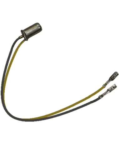

While looking for alternative thermistors, I can across this:
Not a lot of details but may save some soldering, although I expect the plug will need changing.
It does seem weird that there can be electrical connections inside a petrol tank.
that’s handy and only a few euros. Better than 160 odd!
At that price it saves all that fiddling about.

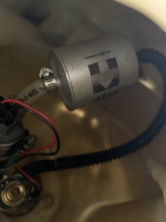

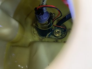

I decided to have a look through the fuel filler cap to see if I have a metal or plastic filter. After removing the cap assembly I used a small led to light inside the tank, and to my surprise, could clearly see a metal filter!
It was also easy to see the thermistor that needs replacing. So at least I’ve slightly more of a clue as to what I’m changing.
It’s nice when things work out!
