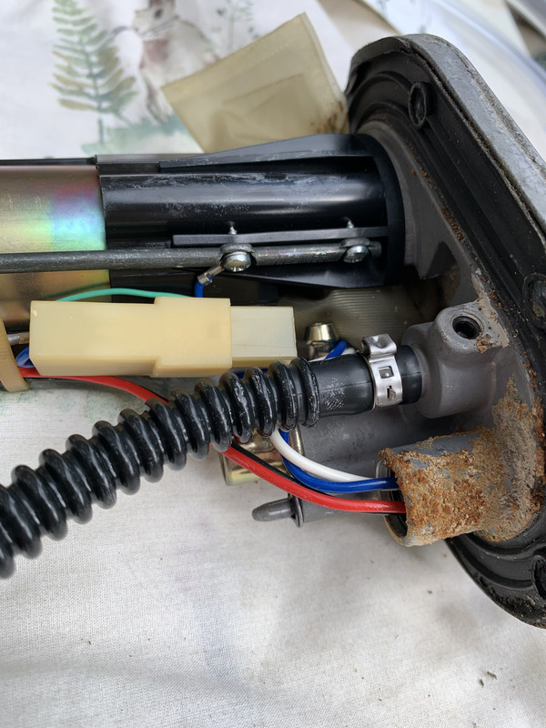

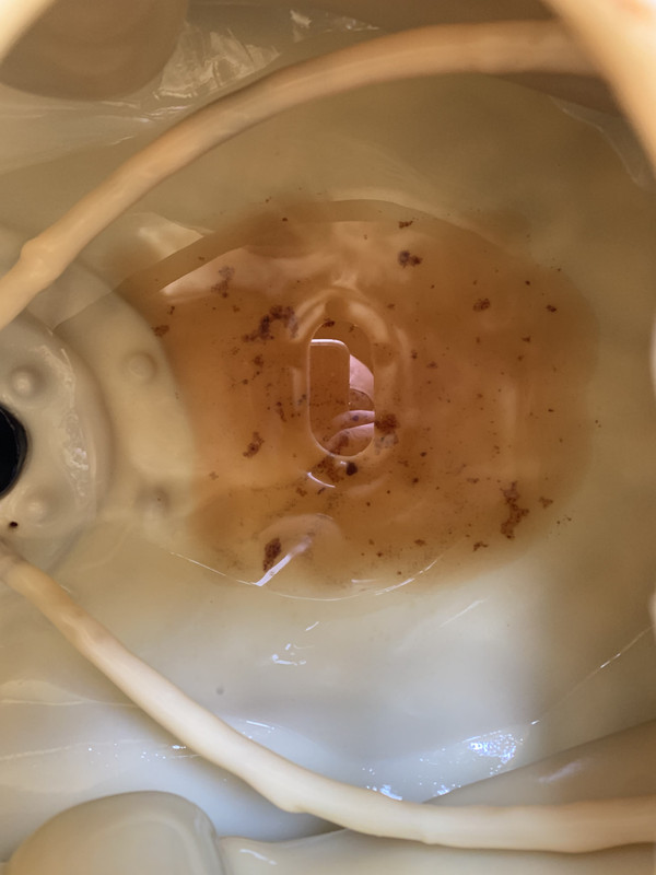

Hi Brian, I’ve just taken the tank off and there’s an alarming amount of crud in it.
Might be an idea changing the filter more often than I thought.

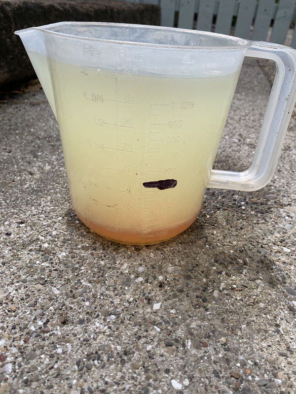

It gets worse!
When I poured out the dregs, look what was there.
I’m guessing the bottom layer is ethanol and impurities. This is on a bike with only 4300 miles, with the last two fills (my ownership) being E5. Plus, as it’s a Mahle filter and jubilee clips, the tank has been open at least once before.
As you probably know the ethanol is hydroscopic and grabs water from the air above the fuel, some of which settles out as temp changes. Add the water that tumbles in from the filler well when the drain blocks = a lot of H20 in the fuel and that is why there are rusty steel components around the pump and filter.
Apparently the spring in the fuel pump non-return valve can rust to the point of failure - but i don’t know if it is available separately sorry :frowning:
