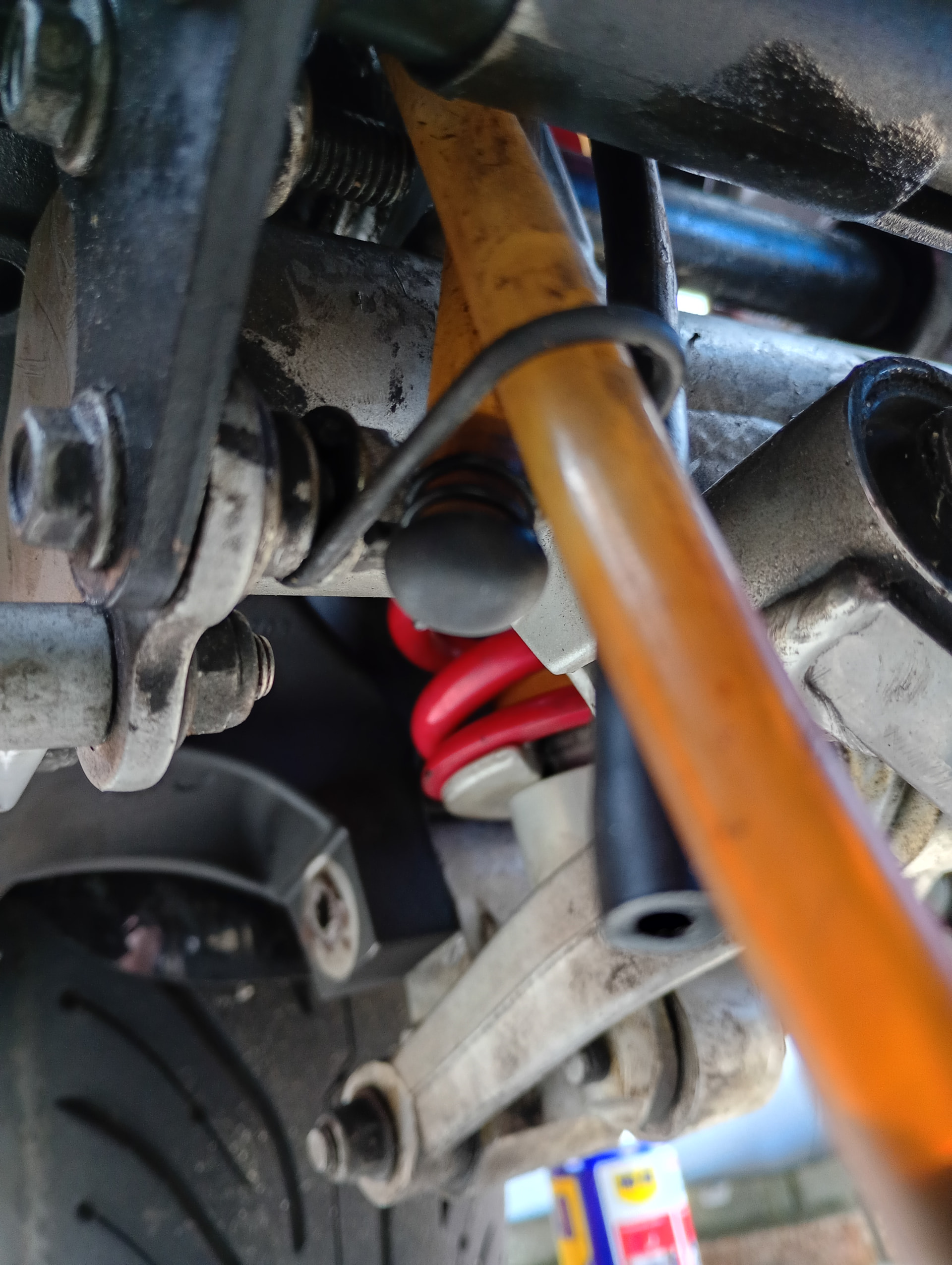

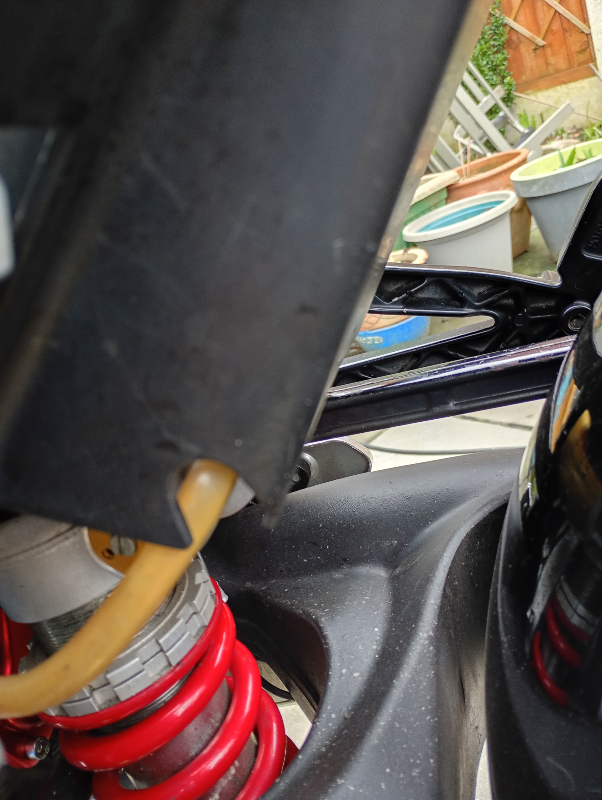

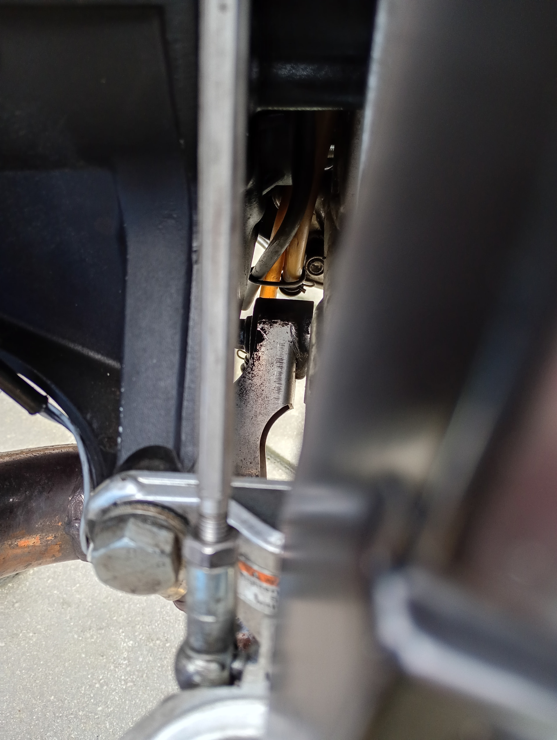

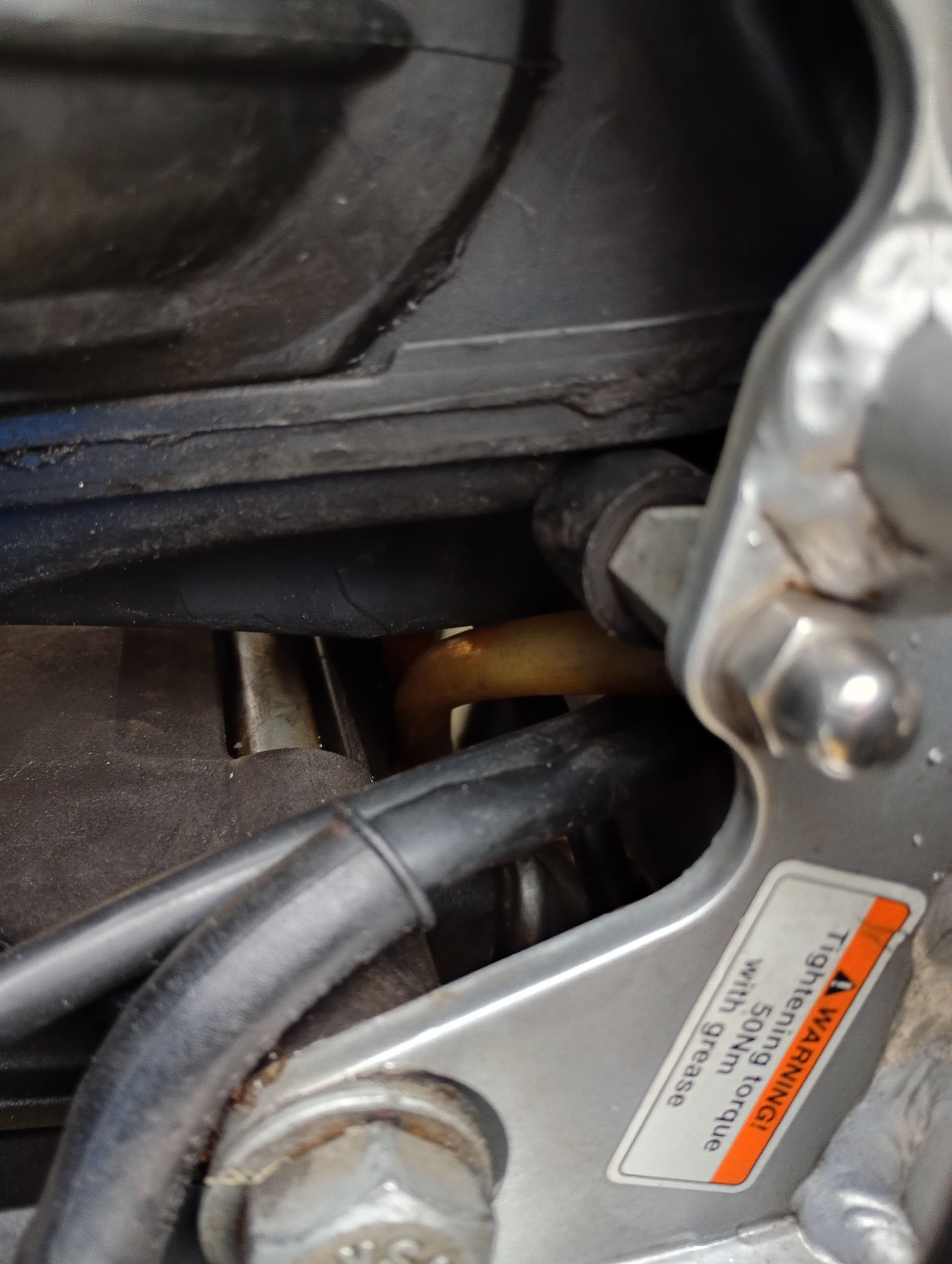

Problem now solved. After inspecting the gear linkage I was able to see that the gear pivot arm that the linkage is attached to at the top was being fauled by one of the clear drainage pipes that runs from the air box to hang nearby the rh foot peg. Consequently it was obstructing the up shifts but not the down shifts. A fiddly reroute was done and the linkage moves freely up and down. Whilst haven’t done a road test … freezing here .. I’m confident the issue has been sorted. You couldn’t make it up could you :rofl: but thankfully nothing complex. Thank you all for your help with this. Cheers :blush:
