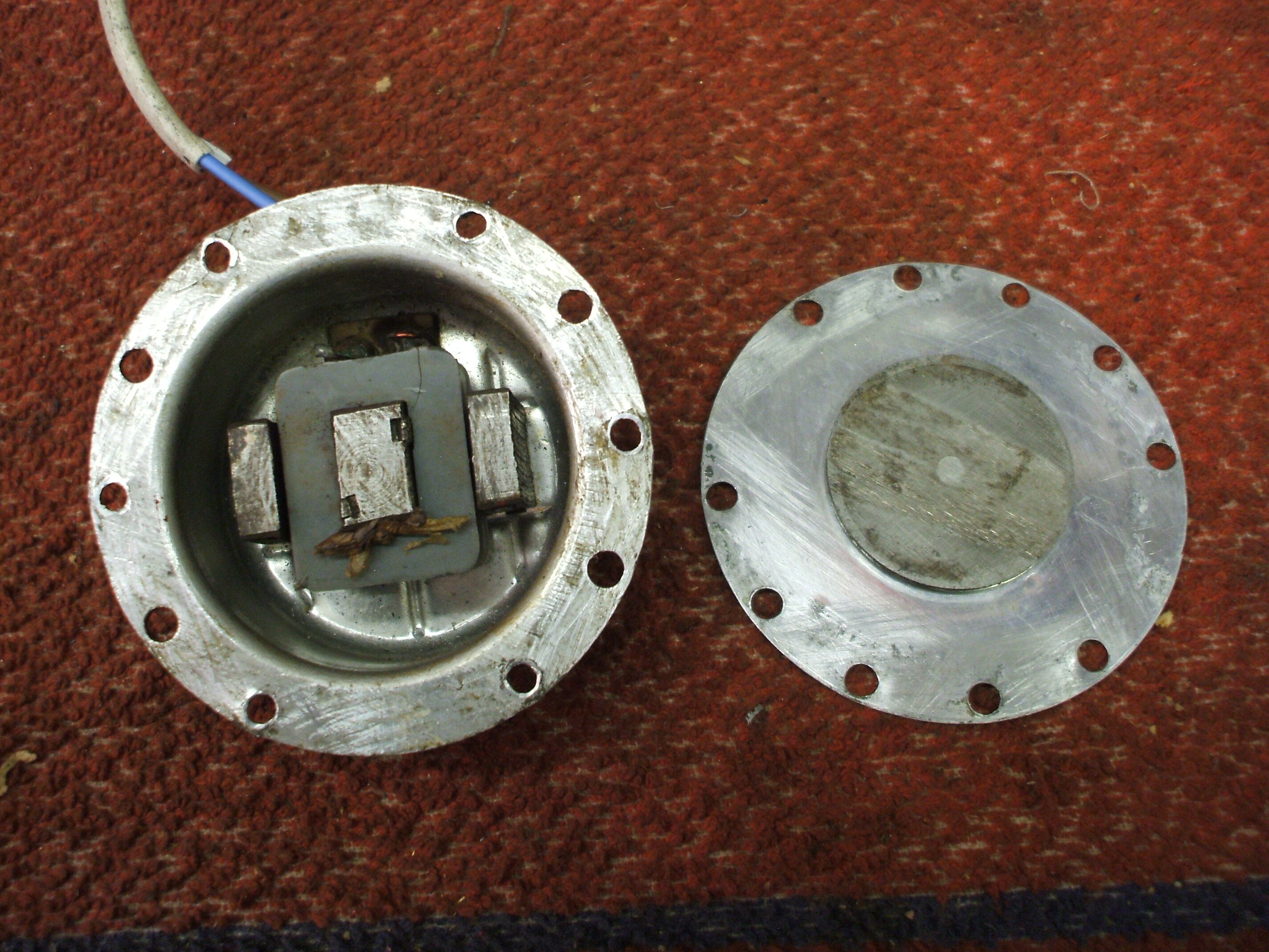

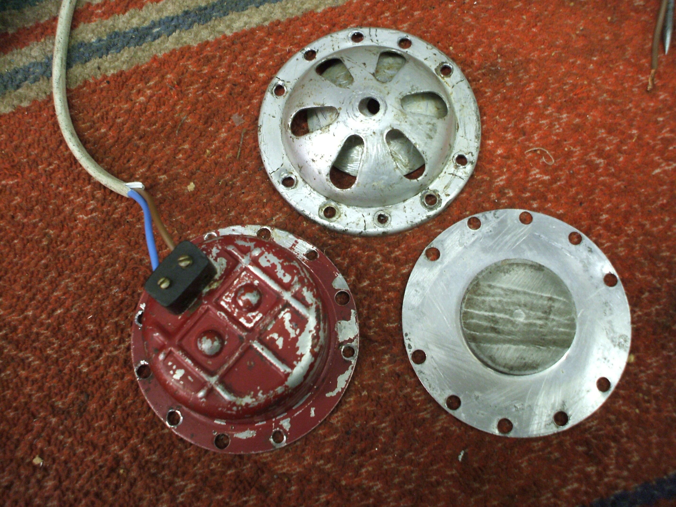

In the meantime I am trying to recover / repair a very dirty electric 6 volt horn.
I have scraped a 3 to 4 mm layer of “something” from both the outside and the inside of the horn body.
Applying 6 volts to it and the diaphragm pulls down onto the electromagnet and stays there!! It does not release. There does not seem to be any points or current interrupter in the case at all. Obviously if I leave it connected it will burn out the coil.
I have attached a couple of pictures.
If any one can advise on how best to proceed I would be most grateful.
Cheers , Bryn

Just for the record, I resolved the horn problem. The alternator on the bike generates 6 volts AC, so the AC current makes and breaks the circuit itself. No need for contacts in the horn body. Can’t think why it took me so long to twig that!! All fixed now. Makes a horrible sound, but it is original.

is it an A.C. horn fed via the generator coil ?
I recall from my early training that some motorcycles and early cars used A.C. horns, thats why they dont have points
Gent of Leicester used to supply some big old horns, looking like a gramophone, they had no points but used A.C. mains to oscillate the diaphragm
Hi raphael_glynn,
Thanks for your thoughts which are indeed correct.
It took me a while to remember that it’s an AC generator on this bike !!
I was able to rig up a 6 volt AC supply to test the horn and it worked well, albeit a terrible tone !! I’ll live with that.
