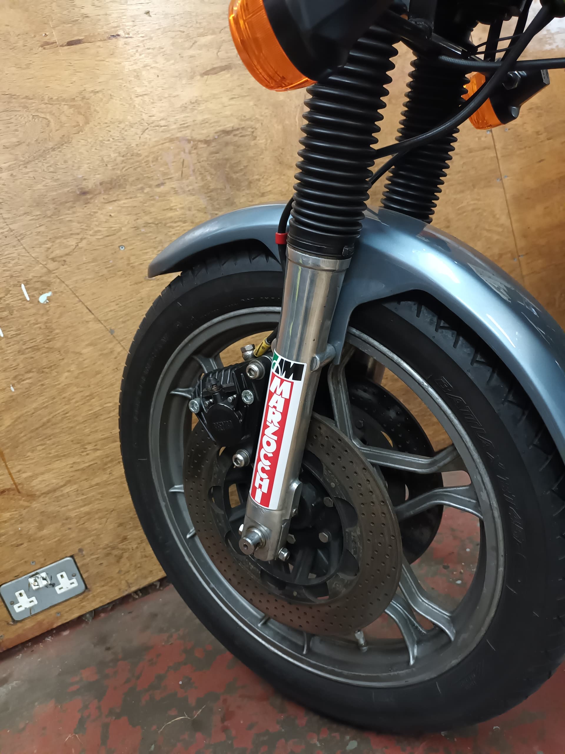

LM1 with 38mm Marzocchi Forks clonking
Hi,
The forks compress and rebound but maybe too much give. Lots of clonking over bumps. Not (quite) as bad as the 1st to 2nd gearchange…
New to these forks (rebuilt Roadholder and triumph OIF forks). Any advice welcome on what to check and how to drain and replace the fluid + best weight etc.

But the Marzocchis are different. If the clonking is topping-out ( which I’m guessing from your description ) it implies either something has come undone or, much more likely, there’s not enough oil left inside to provide damping. If that’s the case it’s almost certainly because the seals have hardened with age and leak for that reason. I see the gaiters which should protect the stanchion working surface, but were they fitted because the stanchions were already shot and leaking oil ? If you pull the gaiters up is the chrome in good condition and is there oil sitting on top of the fork seals ?

I just pulled up the gaitors. LH stanchion good. Traces of oil but minimal scoring. RH stanchion. No traces of oil minimal scoring. My Commando stanchions are new, leave more oil traces and work great.
So maybe I’ll 1st try draining and replacing the oil. Can this be done without removing the stanchions and what grade would you recommend- softer is fine as I’ve yet to top 90mph unless over a beer.

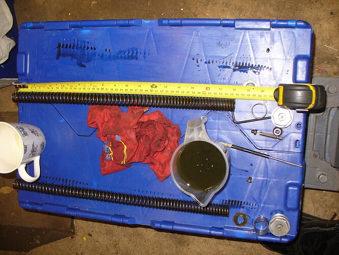

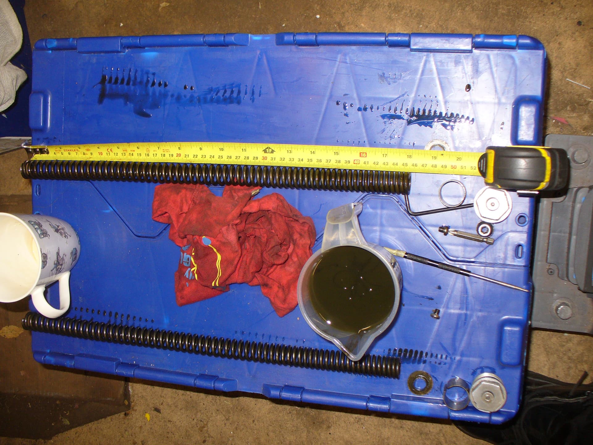

Update,

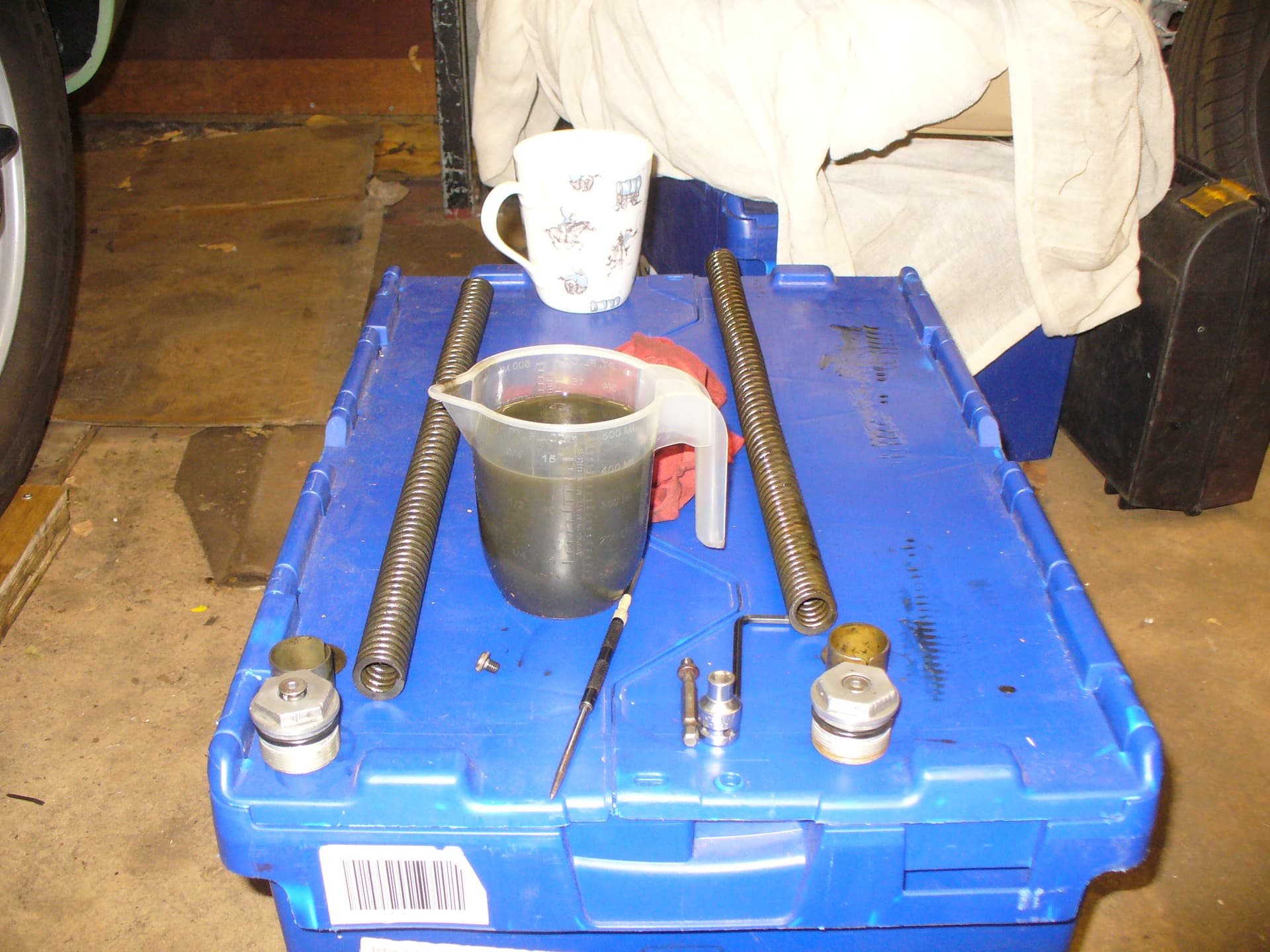

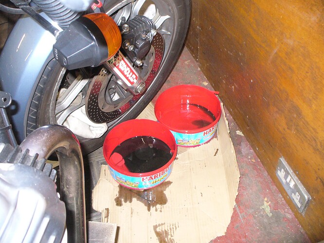

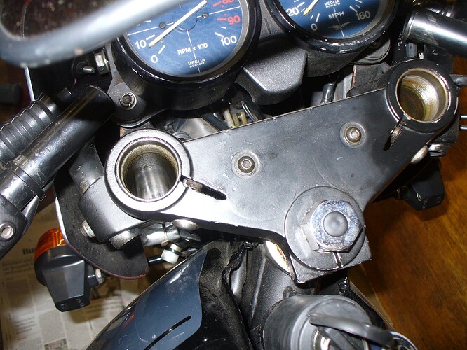

Forks still on the bike. Drained the oil and pumped forks. Springs out.

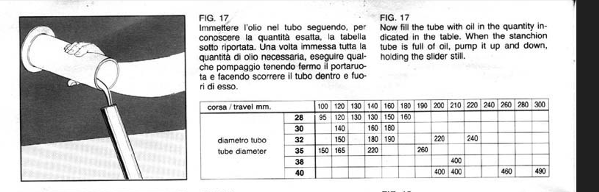

200ml drained out of each leg. Allowing for the oil that missed the bucket maybe 250-300ml. Manual says 400. Oil is filthy. I’ll just try replacing the oil with 400ml.
Ok seals probably need replacing anyway but,
  1. I can check if it makes any difference to clonking with correct oil level or if the whole forks need stripping and inspecting.
  2. Stanchions had pretty much zero scoring
  3. Oil was 12 quid and had some spare so can do another change
  4. Draining oil and pulling springs took literally minutes
  5. When I get to do it properly I’ll have flushed it with decent oil.
  6. Weather is far to good to miss!

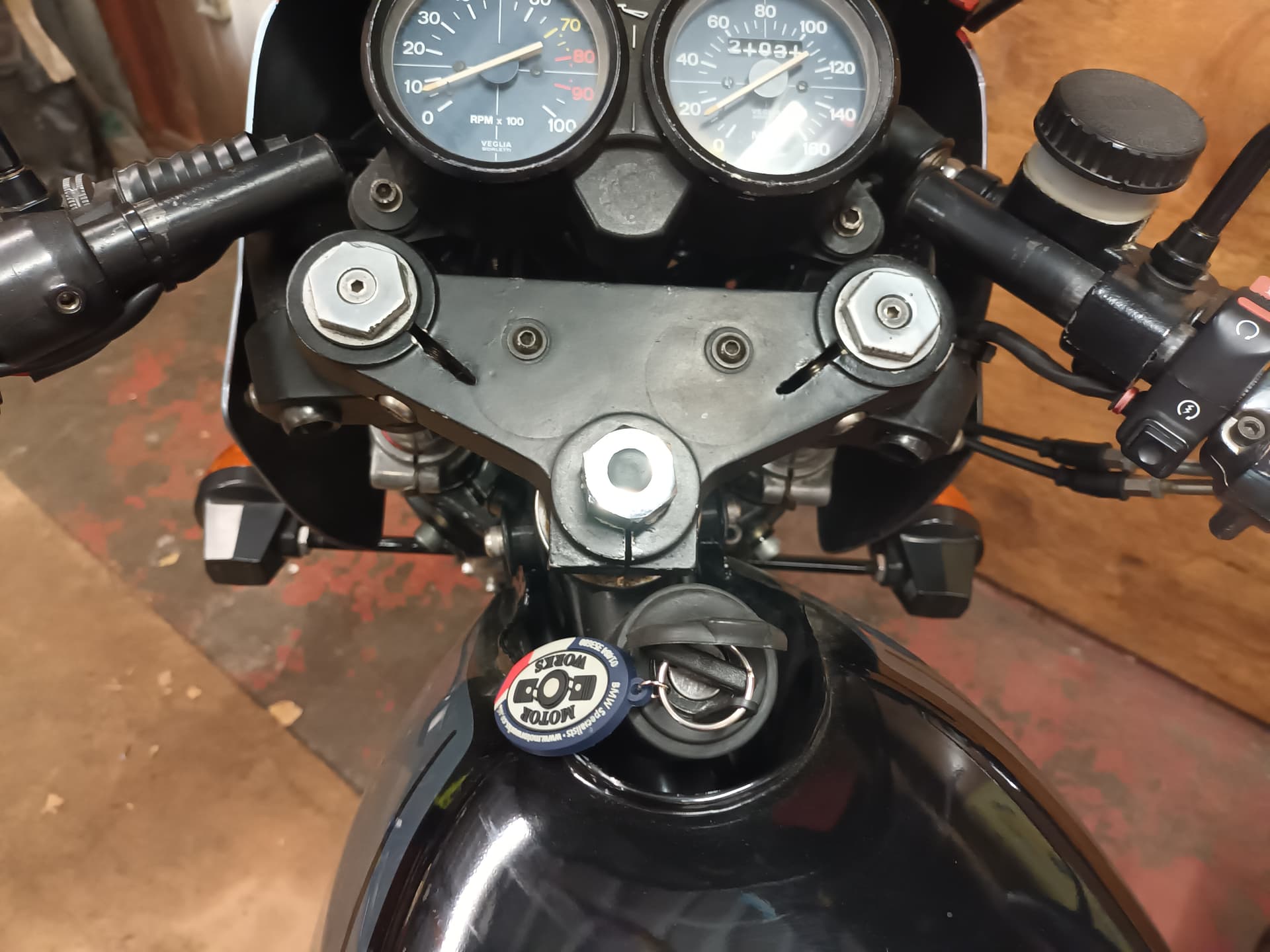

Just a quick gotcha here. After you’ve put it all back together, you may find the forks have locked solid. Don’t panic. There’s an air bleed screw in the fork tops, normally slot-head countersunk, yours look like allens. Loosen these off to let the trapped air out, retighten and you should be good.

Just back from a spin. Much better. Quite firm with the 20wt oil. Not clonk free but firmer and not the feeling of bottoming out. I’ll find some serious pot holed roads for a full check- not difficult these days.

Bit of a run yesterday. Better, but not a massive improvement.
Eddie
Hmm. Did you put 200mL of oil in each leg ? My Darmah, which should be very similar forks, specifies 185mL in each leg. People tune this to their own taste and I see 200 sometimes, 220 others. The factory also claim SAE25, but most pundits say use 20. I’m going to try SAE10.
Bled the air ? The full process, apparently, is to slacken off the bleed screws two complete turns. Bounce the forks up and down. Let it settle into the normal riding position, then tighten up the screws.
The screws have a spring-loaded ball bearing beneath so I think the forks are designed to run -ve pressure. If there’s too much air it might feel that the forks are hitting the bump stop when you hit a big bump ( is that what you describe as clonking ? ).
On the other hand, if there’s too much air volume ( too low oil ), you may actually be hitting the end of the fork travel. Try putting a ty-rap around the stanchion and see how the max travel looks over your bumpy road. Does it look like it’s hitting the end of travel ? If this is what you’re finding, maybe try going to 220mL oil per leg.
Hey there Andy,
Didn’t put 200ml in each leg…it was 400ml (20 weight fork oil) which I assumed from the manual! Doh!
I’ll work through your post and recheck.
Cheers
Eddie
