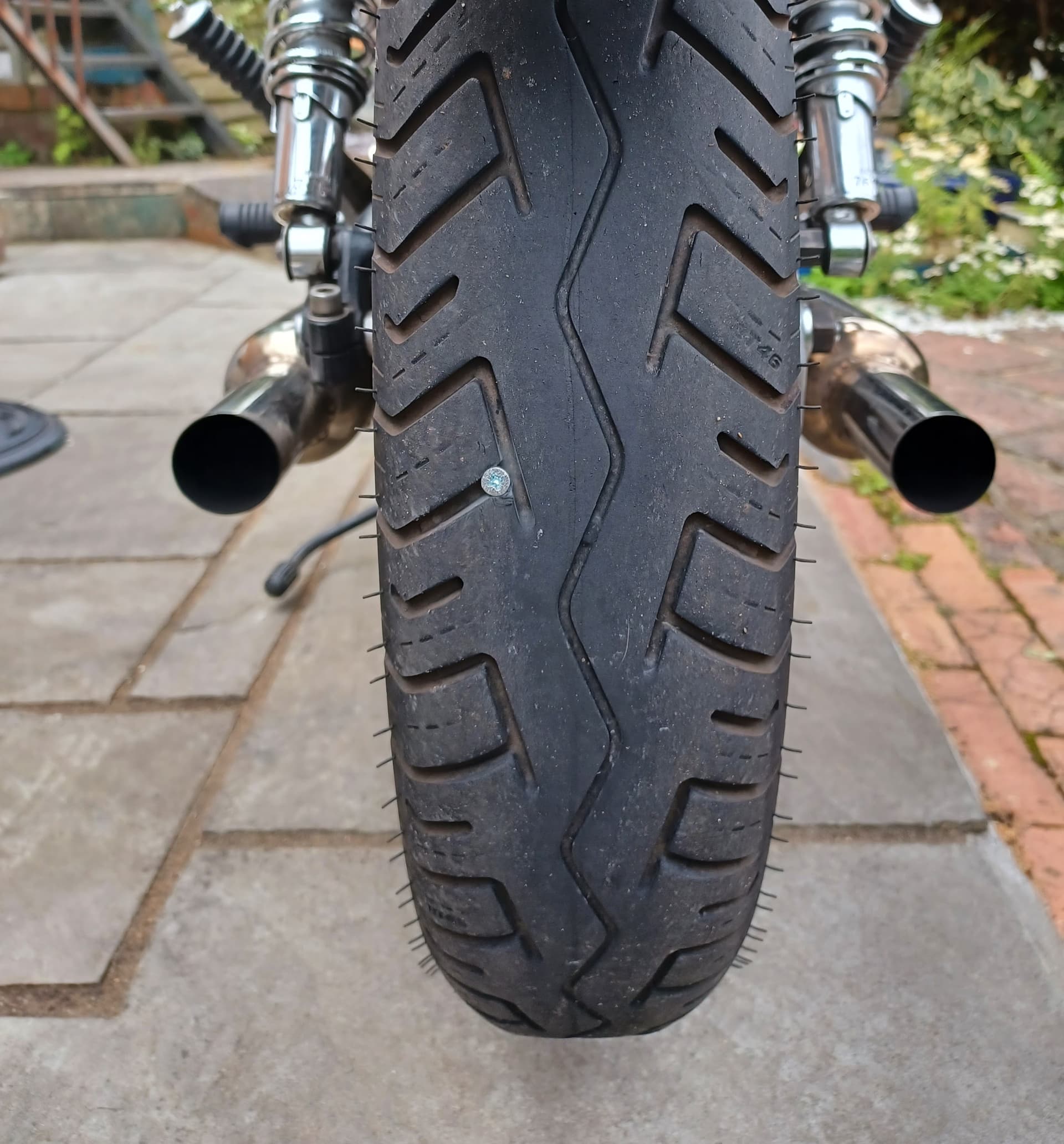

+1 for the bt46 tyres… the screw I picked up today compromised the handling somewhat😬
Ouch. Looks like BT 46’s, then.

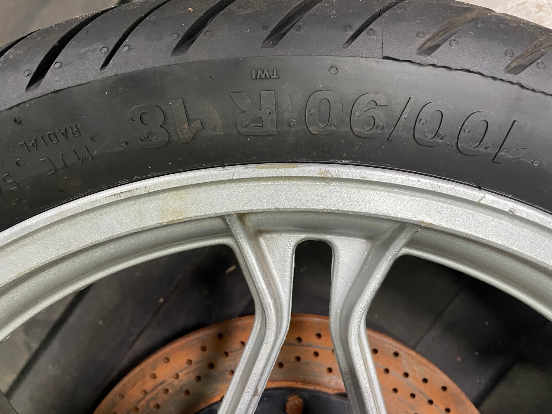

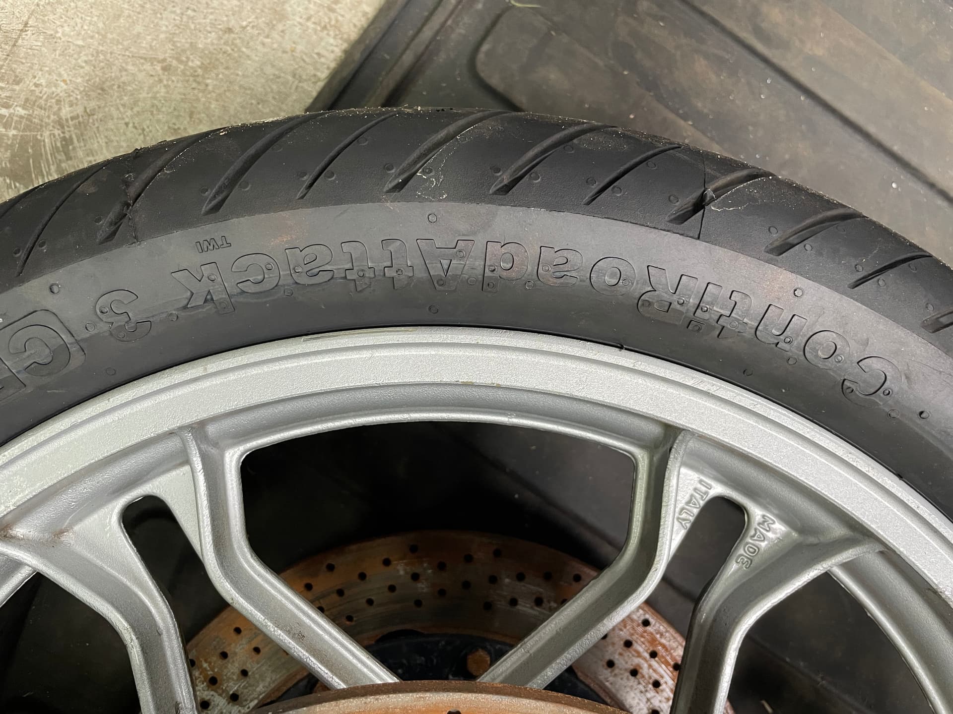

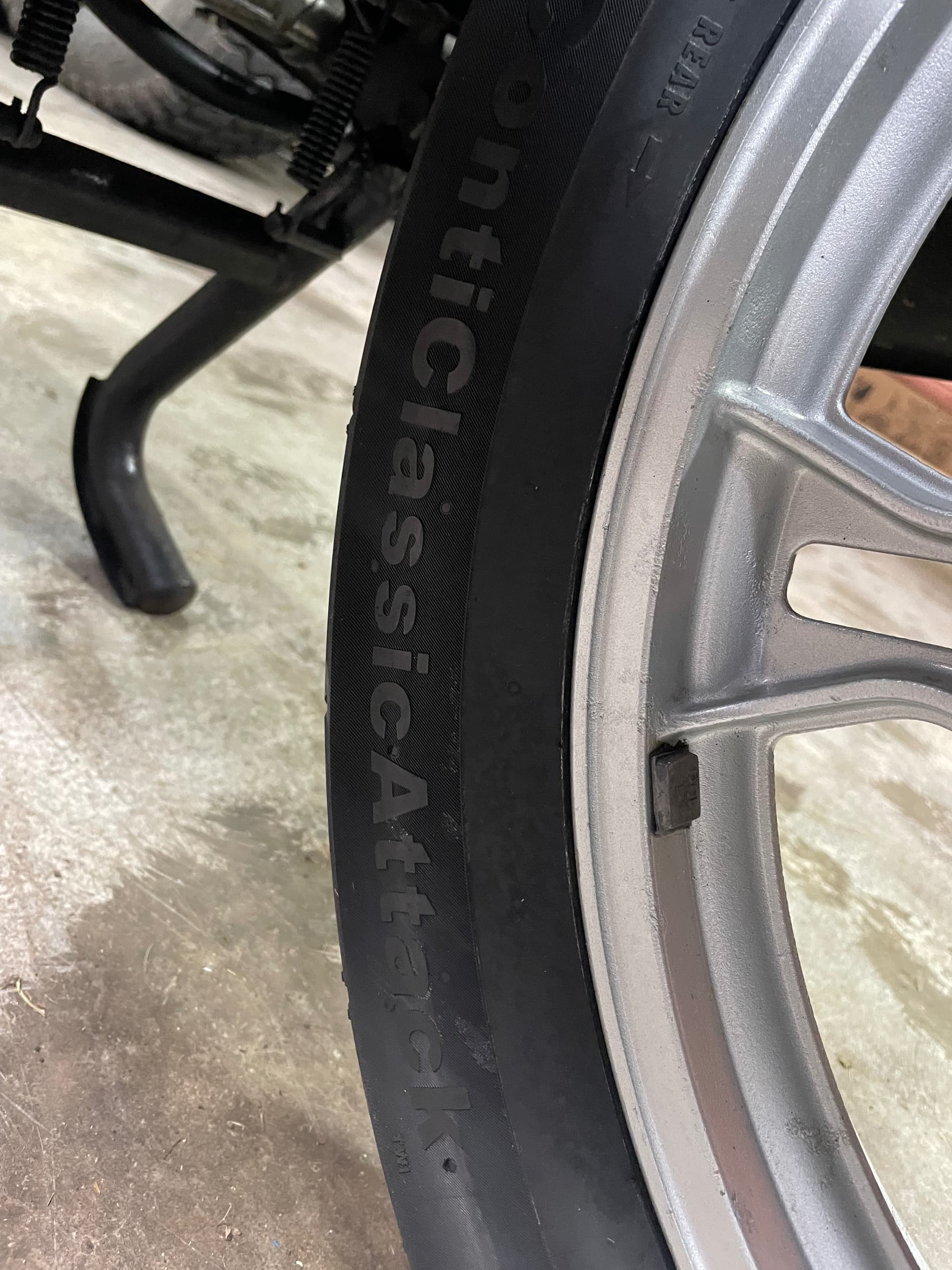

Continental Classic Attack tubeless radials on my LM2.
Hi Alastair
Are you running these with tubes?
Thanks
S23
Running without tubes
You could get them in the sizes ? I didn’t think they made them.

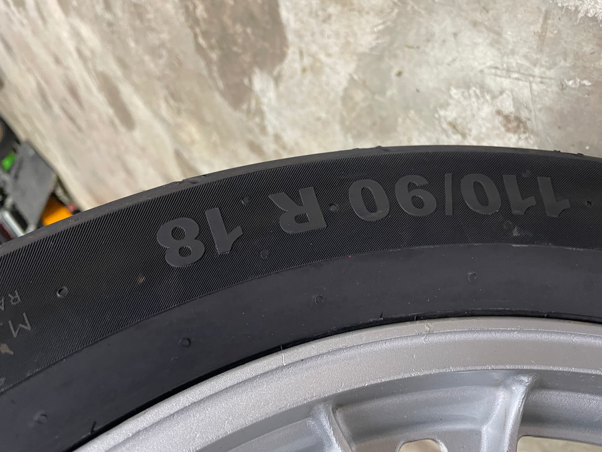

Rear is 110/90 R18
Front is Conti Road Attack 100/90 R18
Any chance of a photo?
Thanks.
