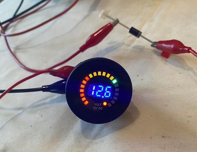

One of my favourite sayings is ā€˜Only one way to find out’ - you can get a cheap little Voltage monitor / meter off say eBay, and cable-tie it to the handlebars.
I did this for the BSA Bantam, as I wasn’t sure whether the generator will actually charge, turns out it does (after rebuilding it with new coils), if too much! The gauge showed me that as well. There is a cheap eBay rectifier / regulator, but it was struggling to hold the Voltage down, so I added a 13V Zener diode (that I just happened to have) across the battery.
Ha! You guys kill me!:joy: ā€œjust happened to haveā€ LOL
So.. if that li’l gizmo is reading in the green I’m ahead of the game? Is that synonymous with the old fashioned voltmeter/ammeter you used to get on yer dashboard in days of old?
I am sooo ignorant about eleckatricity I would be dangerous if let loose! What you didn’t say is what I do with the other end? Like where do I connect it to? I really am that dumb!
That’s an interesting idea. I did a similar upgrade one of my Stornello’s. I had the coil rewound and plugged the output into a Lucas Rectifier/Regulator from Feked com. The voltage did get a bit high when connected to a small sealed battery. A zener should act nicely as a second regulator.
Ground (aka frame, = battery negative) and any positive connection switched by ignition key. In the Bantam’s case, inside the headlamp shell (ā€˜ignition’ is light switch).
