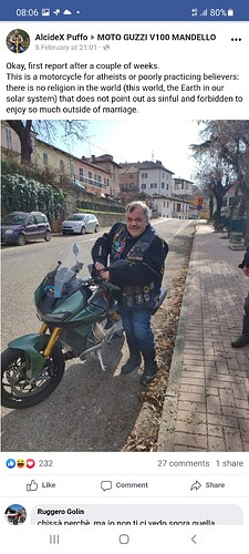

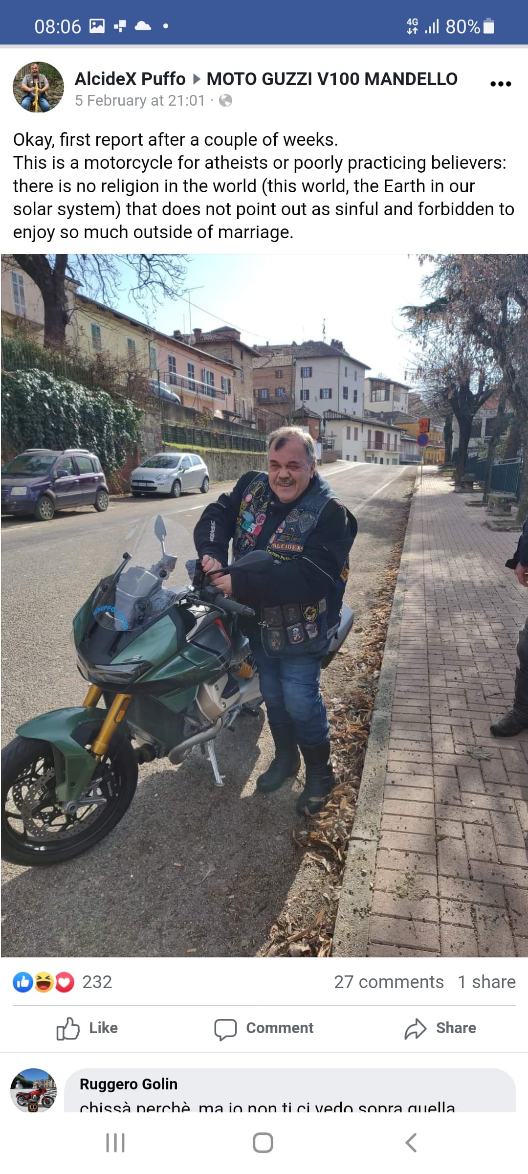

Aha. Just spotted this:
MOTO GUZZI V100 MANDELLO | Facebooktn=C-R&paipv=0&eav=AfbHMXu8YvDKd1TL72tSAvMWxy5MCIWASltswrF3e4LU51GXsCLojfhFwAyte-VfMEk
Look closely at “Alcide X’s” post…
Something wrong with that link? Can only find 4 posts by him and nothing anywhere on that page mentioning the horn.
Hi Mike
If you look at the photo, you will see a Fiamm horn fitted to his bike. In the comments he says that it is a pair of Fiamm trumpets and no problems reported.

No I must be on the wrong page, I keep getting the same 4 posts. No photo showing horns. :disappointed:
Behind the front wheel, low down. clearly visible if you zoom in.
“You call that a horn? THIS is a horn!”
Oh right the black blob behind the front wheel, thanks. :grin:
That part of Facebook is weird to me, I couldn’t zoom in on the picture. :thinking:
[quote=“Mike_H, post:34, topic:14296”]
Oh right the black blob behind the front wheel, [/quote]
There is a pair of them…

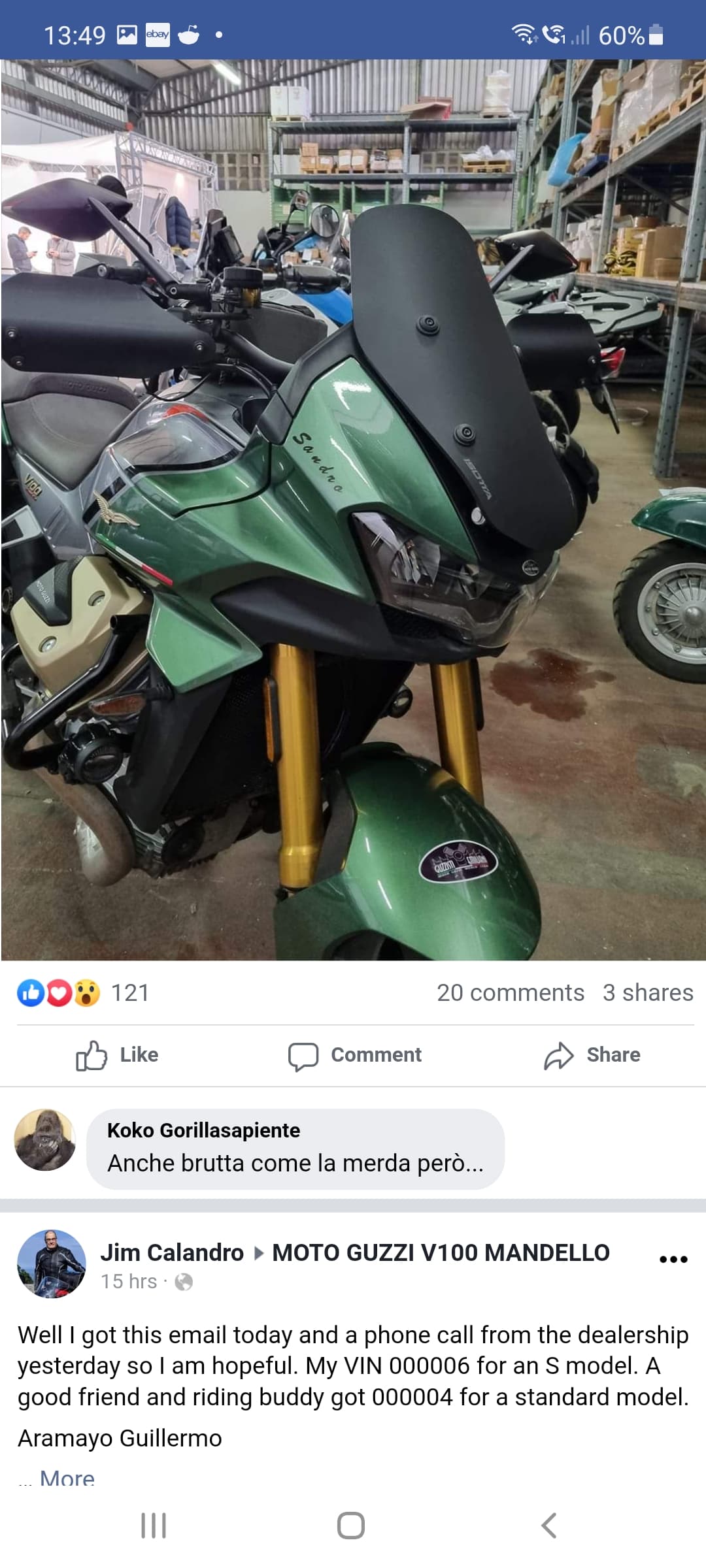

And here is another photo, this time with 2 disc horns…
