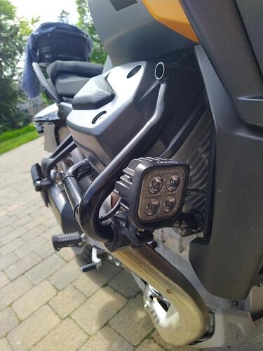

I have a Thunderbox, and also a Denali Dial-Dim controller (V100 Stelvio).
The Dial-Dim allows me to run the Denali D3 lights at low intensity as “DRL” during the day (running powerful LED lights on full power all the time would probably be an offence but definitely disrespectful to other road users)…
Anyway another function of the Dial Dim controller is that it allows you to take a feed off the existing horn (leaving the existing horn in place or removing it, either will work) and then have a more powerful horn connected to the Dial-Dim (I am planning a Soundbomb Mini once I work-out where to mount it!).
The Dial-Dim controller allows you to connect a few different accessories, and is completely harmonious with the bike’s CANBUS system.

Arrived, fitted and works perfectly! Cheers @SteveThackery
May I ask where you’ve mounted it? I had mine where the original horn was, but it looked a bit weird.
I also just mounted it where the original horn was and whilst I agree this is not ideal ascetically it is convenient and allows for a slightly louder sound than when the horn is tucked away up inside the fairing behind the headlight/forks etc. My biggest concern is whether continually getting water thrown at it will cause it to fail in which case extension of cables and higher mounting location will need to be arranged. When my engine protection bars arrive I might see about making a bespoke bracket to mount it higher and to the side. If I change anything I’ll respond again.

I’ve been using these Soundbomb Mini for years on various bikes, and they seem pretty impervious to anything the front wheel throws at them. The instructions emphasise the importance of the opening facing downwards, and I’ve observed that rule (near enough) for all of mine. However, I do like the idea of mounting it on the engine bars. I’m going to check out the feasibility on my bike.
