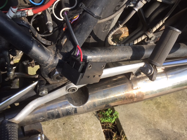

Finally got around to looking into making the solid-state regulator work again. This came from Motobins i.e. intended for R-series boxers but same charging circuit innit.
When I first tried fitting this in 2013 it didn’t work, (red) dashboard charging light stayed lit and no charging Volts. As it was just a small part of a much bigger bike rebuilding sesh, I couldn’t spend any time on it so put the old reg back on so it would work for the time being.

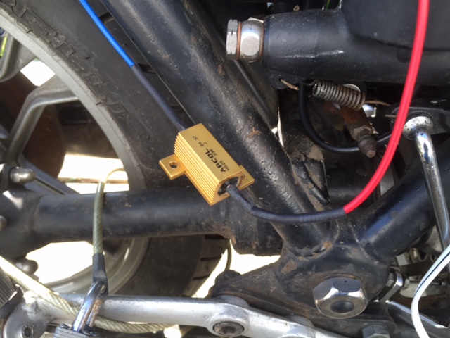

I had a brainwave recently, since the SS reg has electronic gizmos in it, maybe it’s just a case of needing a bit of extra external power to get it going. The current from the dash bulb (100 mA) is not enough so how about shunting the charge light bulb with a resistor in parallel?
I chose a 33 Ohms 25 Watt metal clad jobbie A. 'cause I had it; B. it would be quite easy to install somewhere…

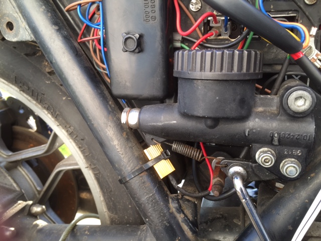

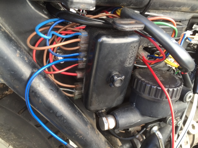

It’s connected between regulator input, i.e. red wire on rectifier, and output of fuse 3 (or 1 or 2) i.e. any point that goes live only when ignition key is on. (Otherwise would be a permanent current drain e.g. if connected direct to battery +.)

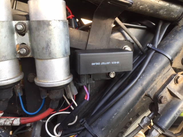

New reg temporarily dangling from connector…
Total current is roughly 430 mA, 330 mA plus 100 mA of charge light bulb, so is not in any way excessive (about 5 Watts), yet raises the Voltage drop across regulator to about 2V which is enough to bias on the output transistor stage.
And it works! 14V at 2,000 rpm. Result …
Installified…
