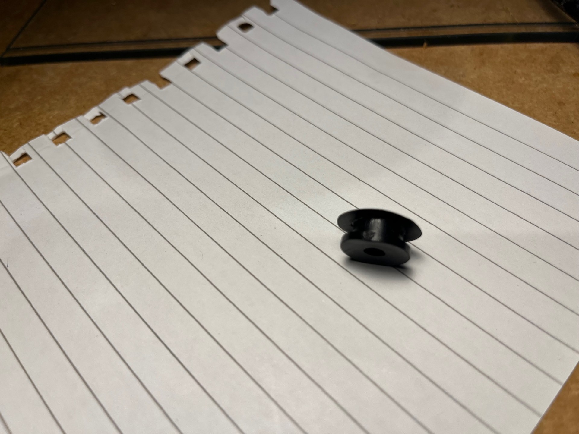

Cleaning my MG V7 Special Edition today and noticed a small black plug on the floor under the bike. I’m assuming it’s from my bike and having spent almost an hour trying to see where it came from I’m at a loss!
Having googled, it does look very similar to what I have. (Frame Plug)
Would appreciate if anyone knows where it should go. (Assuming its from my bike)
Thank you.
Please see image.
Ok, found where it was meant to go.

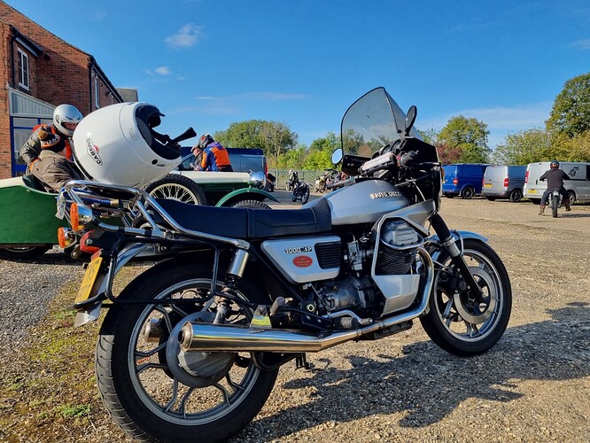

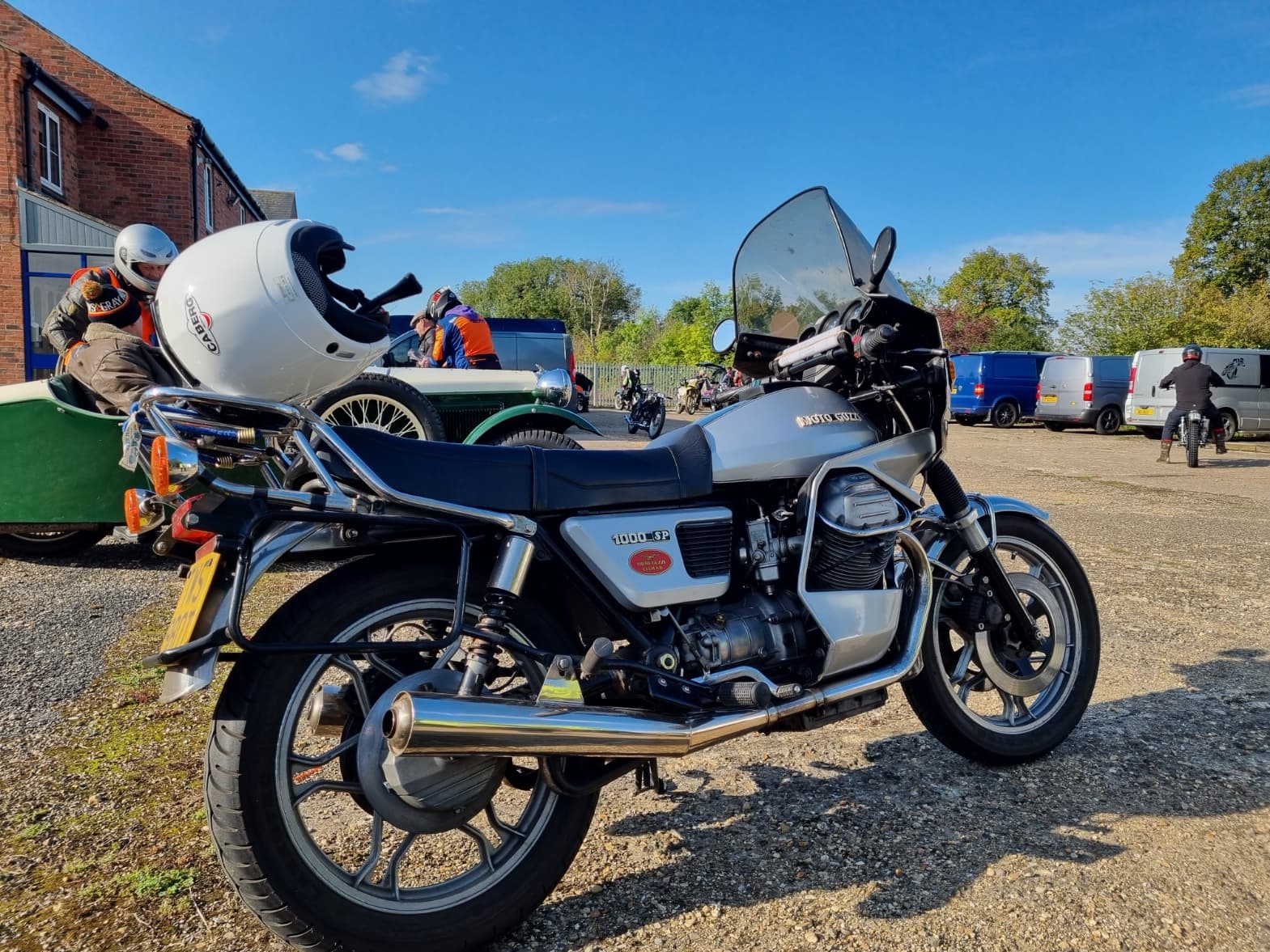

A good day out on the Spada with The Taverners Section of the VMCC on the annual road trial.

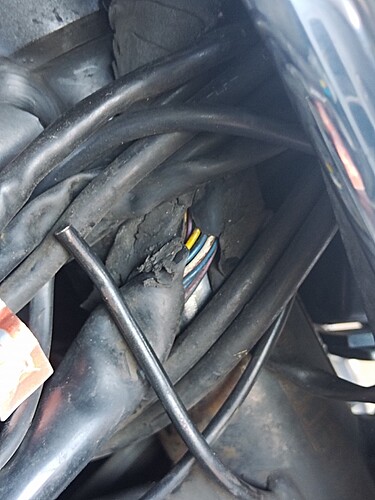

Discovered another broken wire around the headstock :dizzy_face:

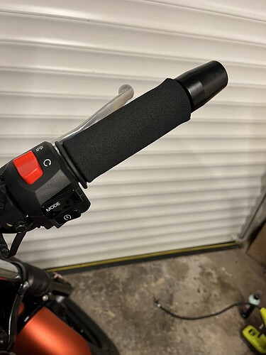

Fitted grip puppies and a givi plate to mine. :grin:

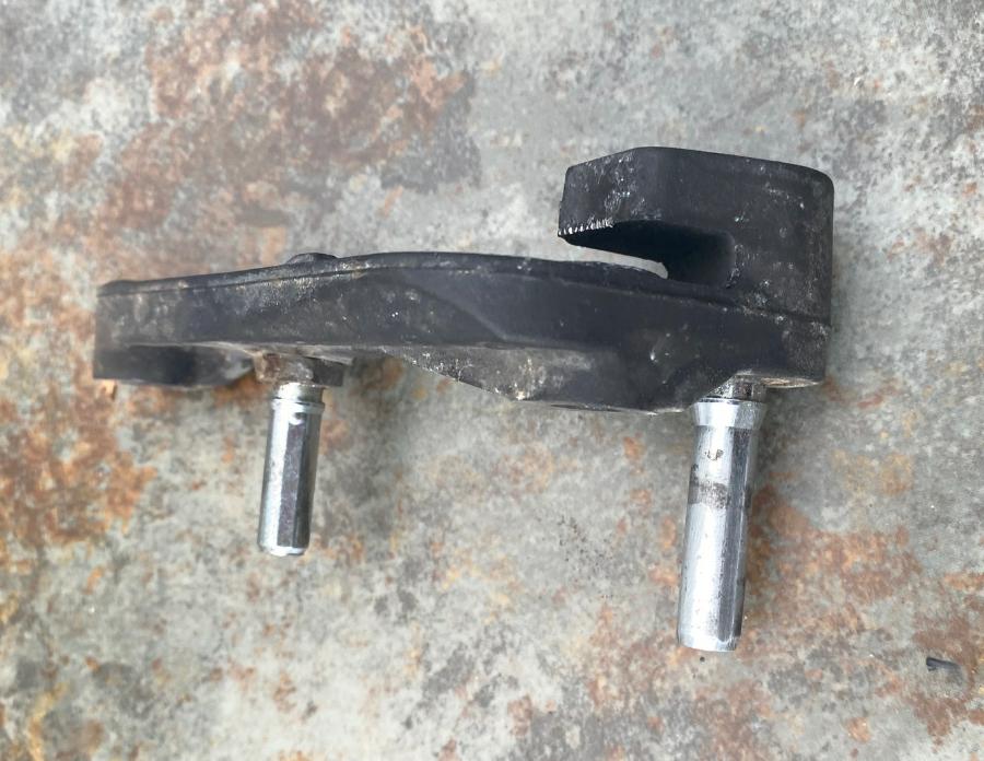

Then I had the rear caliper off for a bit of a clean and check over. I’d had it off before to grease the pistons and change to EBC pads, but according to my notes that was almost 3 years ago. Slung under the hub it’s in the best possible place to catch all the muck and road spray. :worried: I saw recently someone posted photos of the sliding pins on theirs showing bad corrosion, especially the larger pin. Mine had been greased, presumably by me, it looked like the sort of grease I would use but I hadn’t made a note of doing that. Nevertheless the larger pin was showing the beginnings of corrosion. Photo below is after a going over with Scotchbrite -
Regreased and reassembled. A fresh smear of silicone grease around the outsides of the pistons. The exposed hollow interiors of both pistons are rusting, so a light smear in there as well. Scrotchbrite and lightly copper grease the caliper retaining pins. (These have heads like Allen grub screws and are thread-locked, if you don’t remove them and grease while still new they can be seized and the Allen key hole rounds out.) The pads are about half worn and perfectly flat and even, and match for thickness. Amazing! Caliper given a going over with brake cleaner.
