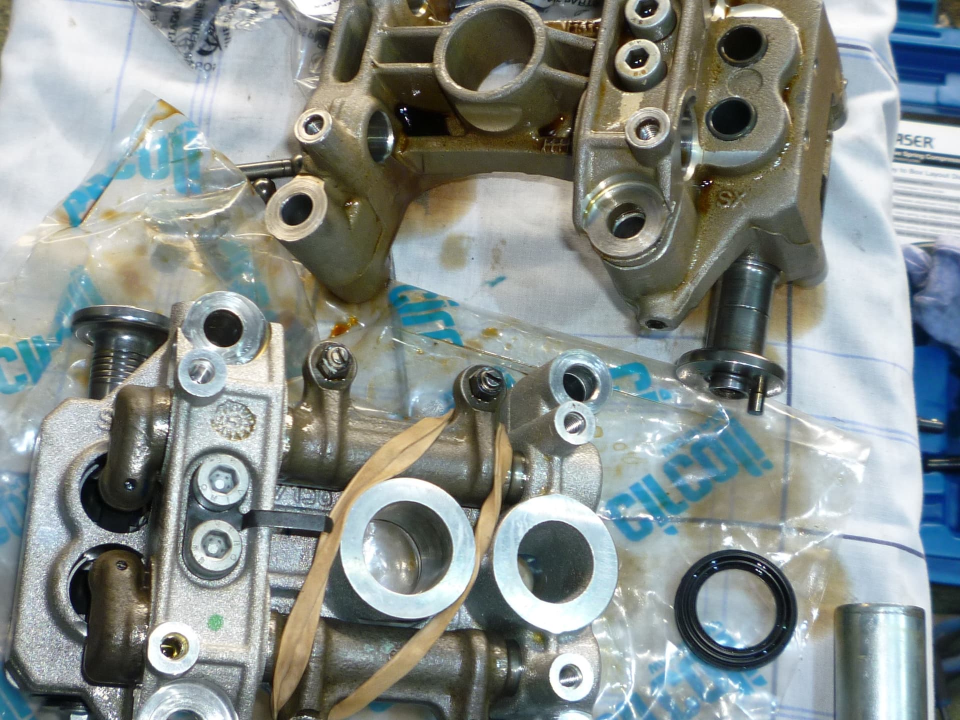

If you can get the rocker cover removed you can see (or ask for proof of conversion)
There are some pictures on griso ghetto of the 2 types.
Don’t just go on the year of registration as some bikes sit in the importers warehouses and showrooms for a few years before being sold. This is quite a big elephant so be sure it is a roller tappet model or has been upgraded.

This shows the difference if you get a chance to look
