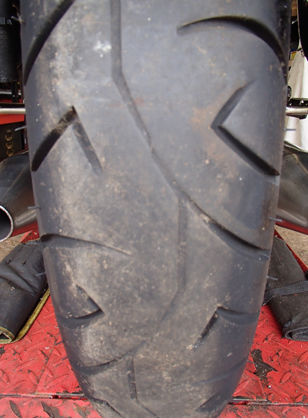

Pulled Blue out from winter slumbers. All serviced during that period but just had to stick the battery back in and then balance the carbs. Due an MOT now, which will be its last. Shame about the rear tyre, I’d become quite attached to that.
Had you monies worth out of that one :laughing:
Yeah, and it was still kind of feeling OK despite the squaring off.

Got a new tyre delivered for Blue, rang the local shop (*) and asked if they could fit the tyre if I dropped just the wheel and new tyre in some time. I was told if I left it with them for a few days they’d see about fitting it in. Is that really as good as it gets these days? Set to and did it myself.

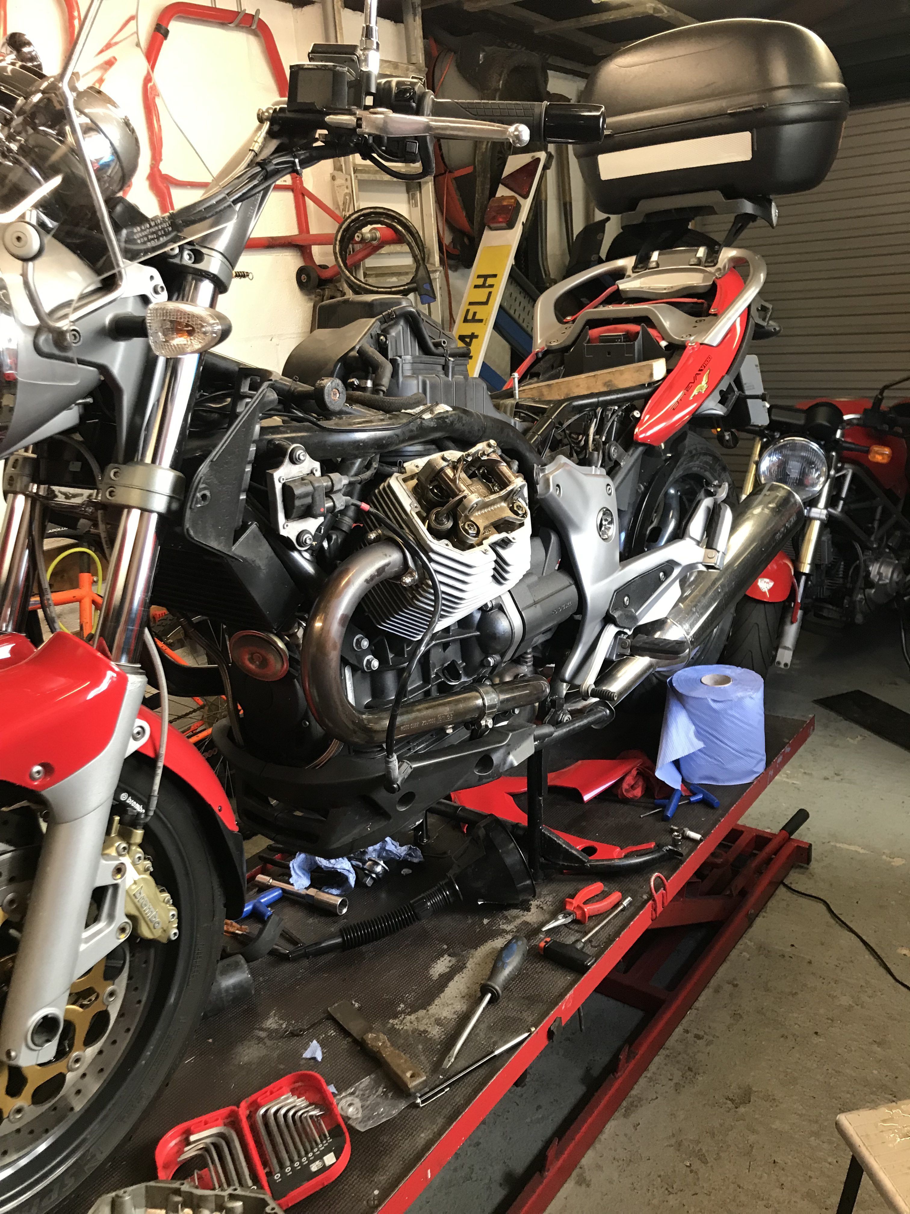

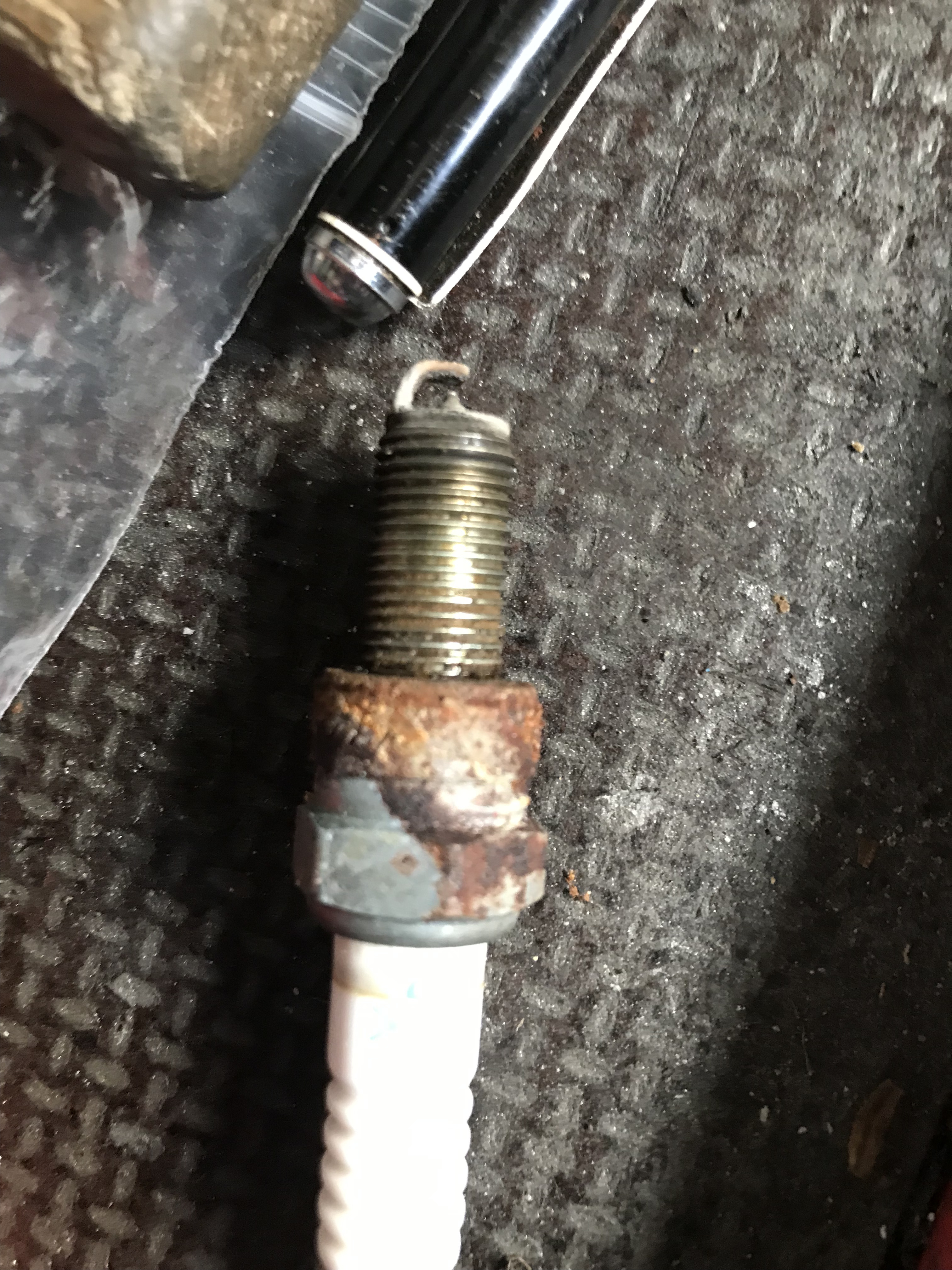

Started the 12000 mile service on the Breva today. The dreded inner plugs came out without drama. Apart from needing the hands of a 5 year old to get at them :grin:
I think the inner plugs were ready for a change. I expect they were in there from new.
